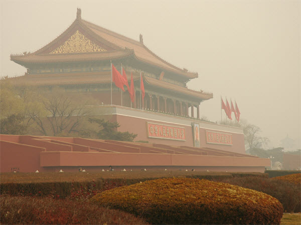

Is there a way to do "Dark Channel" haze removal in PWP? See this for details:
http://research.microsoft.com/en-us/um/ ... he/cvpr09/
It seems lightroom has recently added this.
Tim

1) Starting image from web page:

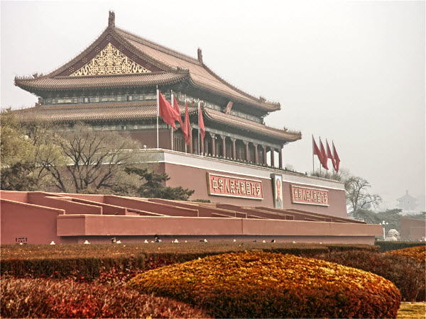

2) Using the Color Balance transform: expanded to full dynamic range and removed color casts from the Black and White points:
3) Applied a modified SNS-HDR Night tone-mapping preset to the resulting 2) image...
4) increased local contrast image areas [shadows, mid-tones, and highlights] to preference using the BrightnessCurve-DetailControl and Sharpen transforms and finalized overall tone/contrast/saturation:
Wonder if the above would be suitable for the full sized original image rather than the posted 600x450 starting image version. I believe I could essentially duplicate the SNS-HDR tone-mapping of step 3) using PWP but it would be very manually intensive using masks, Stack Images with Brightness/Density Curves, and perhaps the Zone Adjustment transforms but I got a bit lazy... :-)

In a neutral haze, the further an object is from the camera, the more light from the object will be scattered out of the path to the camera and at the same time, the more scattered light will be will be added the same light path. Furthermore, on one hand more blue than red from an object will be scattered out of the path to the camera so distant objects could become redder (setting sun). On the other hand, the light that is scattered into the path to an object will be more blue than the ambient light. Overall however, experience shows that the former color effect is greater than the latter. Thus, one way to reduce haze is to subtract white, color correct, and then multiply appropriately, performing these transformations through a mask approximately proportional to distance. In the case of the example being used, this can be a gradient mask from approximately lower left to upper right. Without taking the time to fiddle and get amounts just right and also ignoring the distant building, this series of transformations (plus LCE) gave me the following image.
