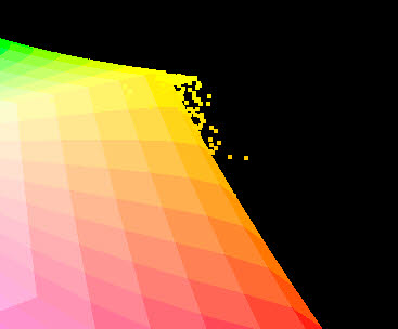

Charles, I had the chance to run a test with ColorThink at a friends place.
One can plot colorspaces, and also load pictures to show their actual gamut.
The solid is Chrome2000D65 and the cloud of points is the image.

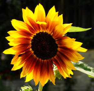

The image is one of a sunflower, light from back, developed to ProPhoto.
The image here is in sRGB for better appearence on the web.
