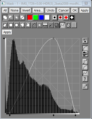

To use the Color Balance transform to expand/check for full range and remove black/white points color casts, yet preserve magic hour mid-tone lighting (white balance)... ...try using an Inverted mid-tone range Luminance mask with perhaps a Smooth curve: 0,0 5,0 65,100 95,0 100,0 ...
Screenshot (3).jpg (50.87 KiB) Viewed 6614 times
As the Color Balance transform uses the RGB color space model, a Luminance mask will give a nuance difference to the default HSV-V mask of the Mask Tool - Brightness curve.
A Luminance mask may be created by Extract-ing the image's Luminance channel and forming the mask on it, then using that as the Amount Mask of the Color Balance transform...
