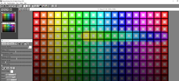

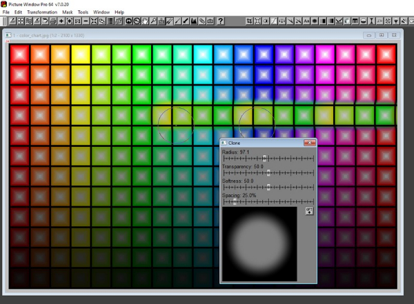

I notice different behaviour when cloning in PWP8 from PWP7. Make a selection, then click+hold to paint the selection over a wider area. In PWP7, the selection picks up the "new" pixels, while PWP8 picks up the "old" pixels... Here's some pictures to illustrate:
PWP7
PWP8
I'd prefer the way PWP7 handles it, but I'm wondering if the change was deliberate?
Also, I found that when making this example, when the mouse drags beyond the edge of the image window PWP8 crashes.

I came back to this and realized I had misunderstood your original post.
Yes, the difference is deliberate.
In PWP8, when cloning an image onto itself, pixels are taken from the results of the previous strokes instead of from the current image. This avoids the problem of overlapping source and target areas causing the same part of the image to be repeated over and over as you drag the tool, which is seldom a desirable effect. As long as the source and target areas do not overlap, PWP8 should be the same as PWP7.

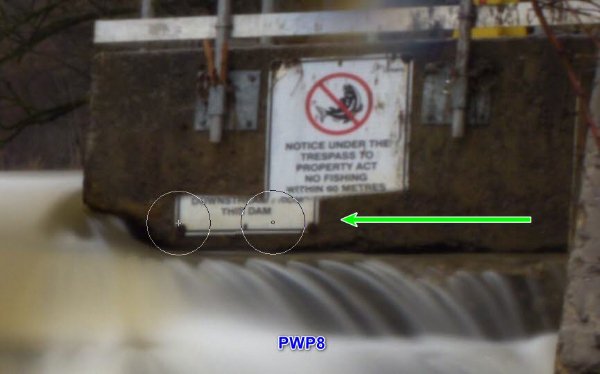

I guess I've gotten used to how PWP7 does cloning. PWP7 is different from other software is in this respect, and I find that when replacing large areas of texture the method used in PWP7 makes it much easier:
The way PWP8 (and other programs) does cloning, means more work, in this type of situation:
I'm wondering if this might be something that could be an "option" for the tool. To be able to switch between the cloning methods depending on the situation?
