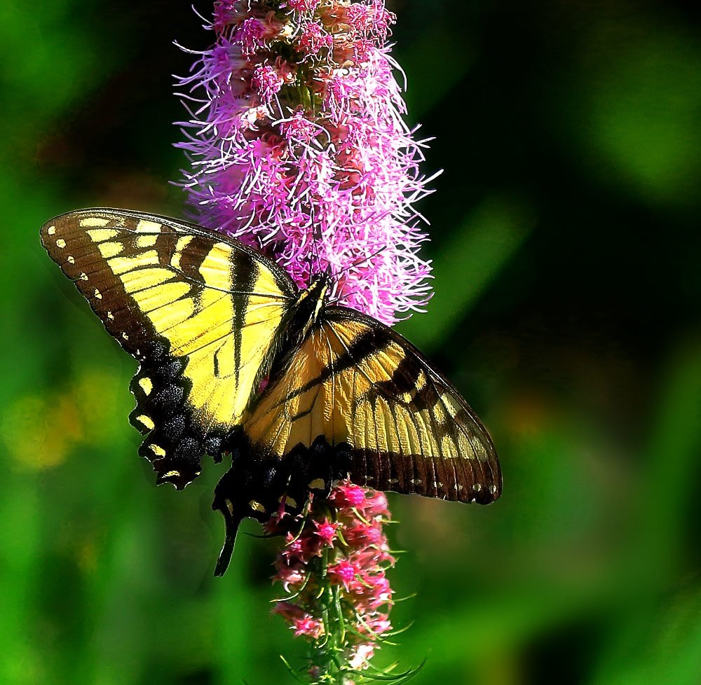

The border of the bottom half of the red flower behind the butterfly's right wing (somewhat accentuated by the size reduction and conversion to jpg) illustrates the problem.

Re: Selective Color
I tried a few things and ultimately settled on this approach:
1) Create a mask that covers the blurred background flower using a series of flood fill operations and painting a soft edge around it.
2) Composite a shifted version of the image with itself to cover the masked region with other parts of the background.
3) Blur a somewhat larger region to smooth over the transition between the the old and new background.
Far from perfect, but maybe a good starting point and a few ideas you could use.
I had to zip the workspace script to get it to attach.
Before running the script, copy the original image to the clipboard. The script pastes it from the clipboard and takes it from there.
- Workspace.zip
- (10.9 KiB) Downloaded 254 times

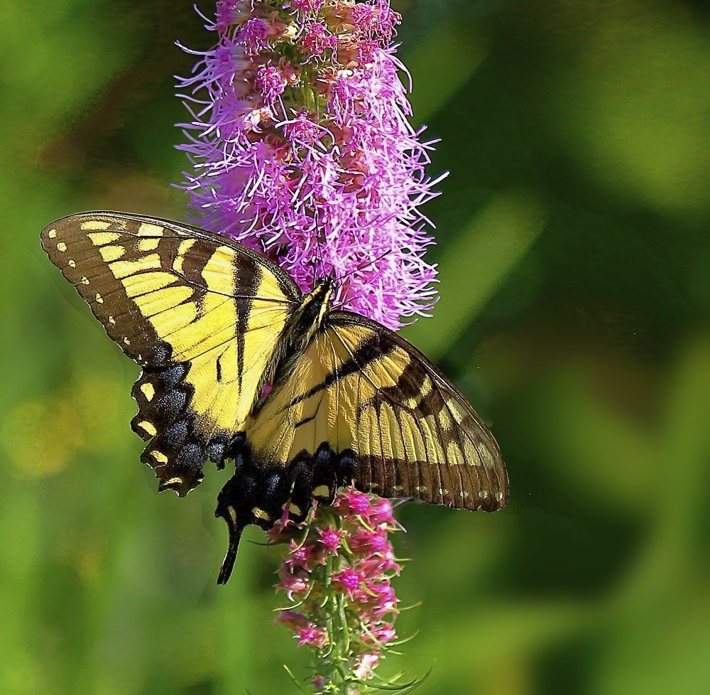

Re: Selective Color
Thank you. Looks pretty good.

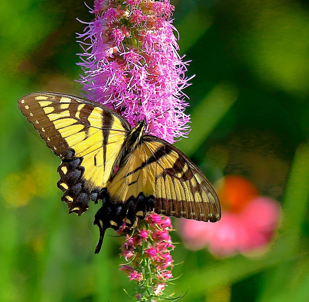

Re: Selective Color
Starting with the original image version... basically did as JS suggests to make the background more uniform, then:
1) used the Filter transform to basically vignette the background and add color/contrast to the butterfly/flower
2) created an Orton version of the resulting 1) image version with a preference HighKey brightening curve
3) Blended 38% of the Orton version with the resulting 1) image version
All along using 1:1 Cloning from various image versions to preference blend/touch up/blur... .
- Example v1.zip
- (11.11 KiB) Downloaded 256 times
